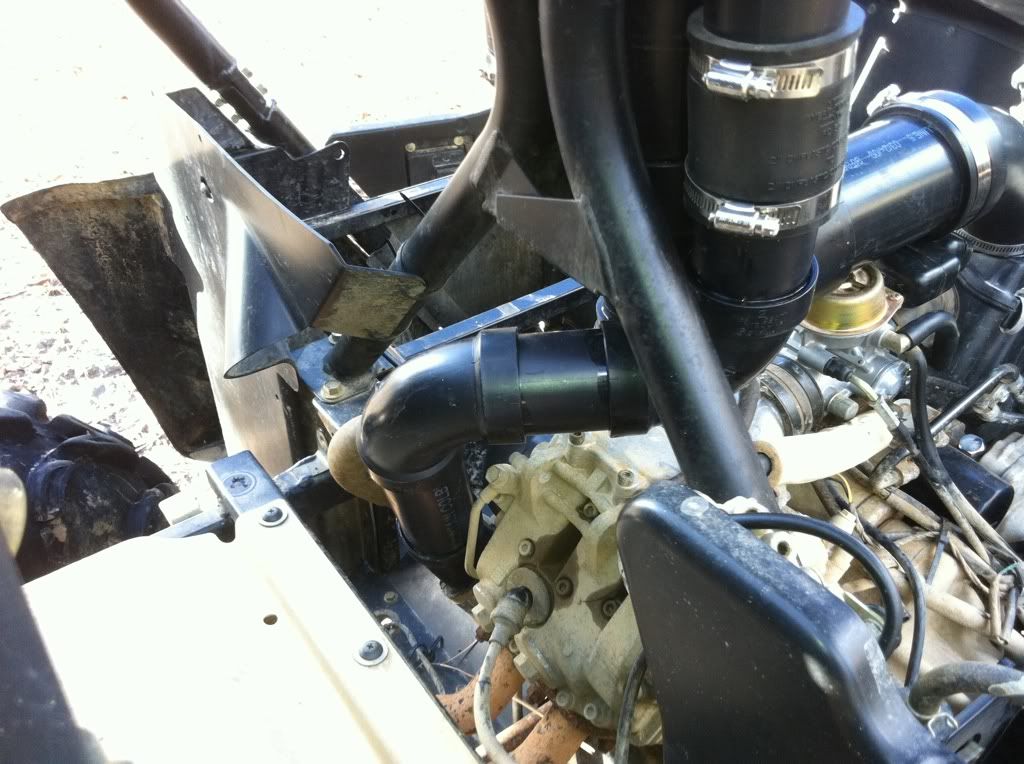

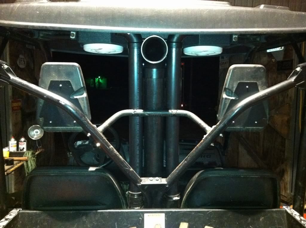

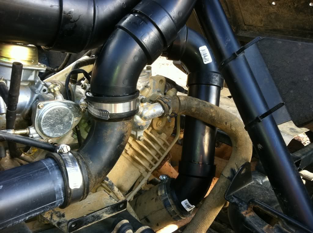

Here's my snorkel setup. I ran 3" for the intake and 2" for the belts. The 3" will require jetting and I couldn't reinstall the original intake cover on the engine cover. Parts used:
Intake:
1- 3" rubber 90 (cut one end off)
2- 3" reg 90
Belt intake:
1-2" reg 45
3-2" reg 90
I cut the stock rubber piece that attaches to the motor and then rotated it up
Belt exhaust:
1-2" long 90
1-2" rubber 90
1-2" street 45
1-2" reg 45
1-2" reg 90
I cut the end off the stock snorkel that attaches to the stock rubber boot and glued it on one side of the 2" long 90
I also built a support bar that bolts to the cage. Its not needed but helpful.
