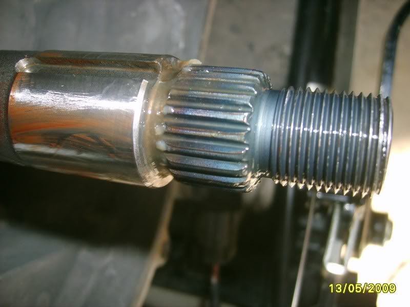

after 3 days we finally took out the primary and the broken bolt inside came out, apparently no damage was made

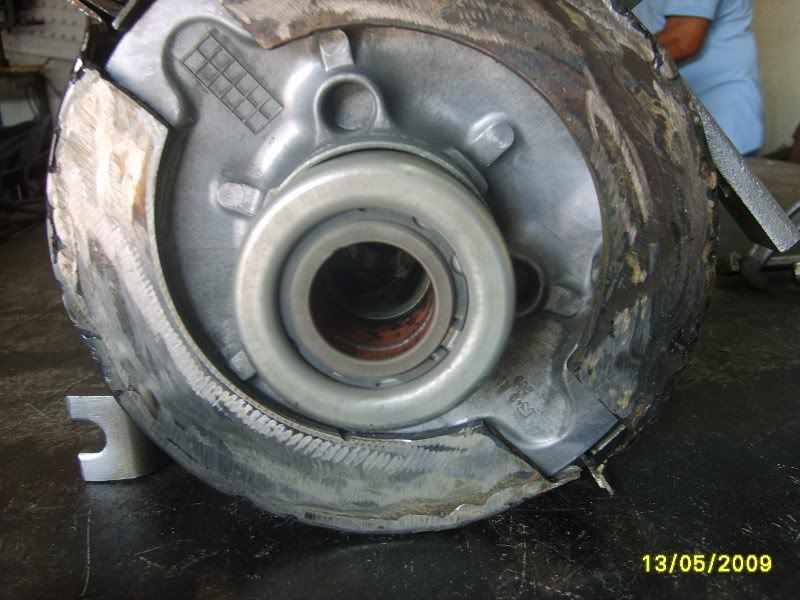

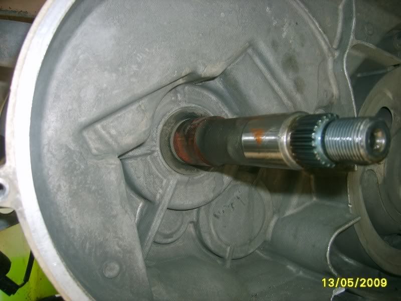

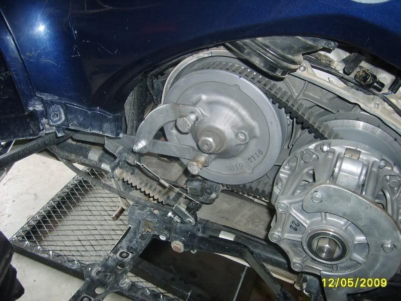

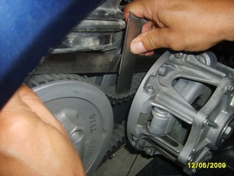

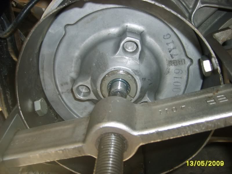

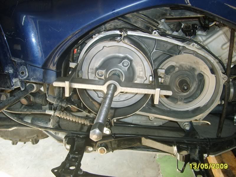

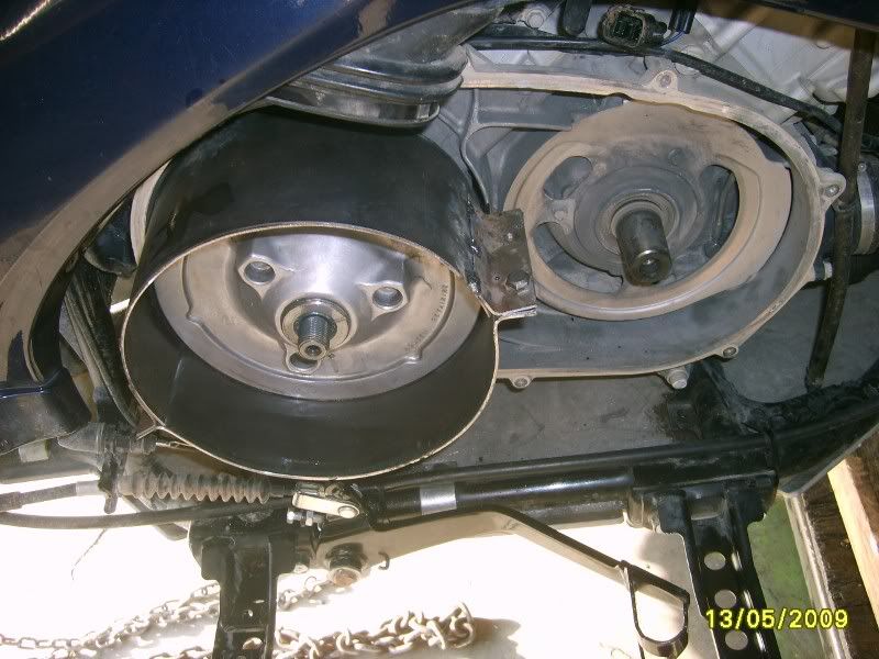

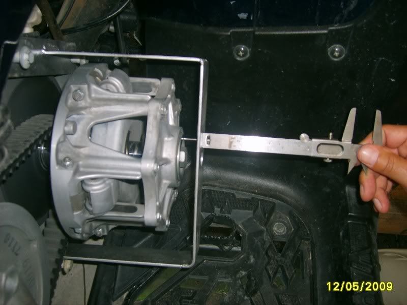

well here are some pictures of some of the tools we made to take out primary and secondary, the secondary had rust in the shaft and it was very difficult to take out

did not buy it, I made one with the specs that are here in the forum, it worked great
