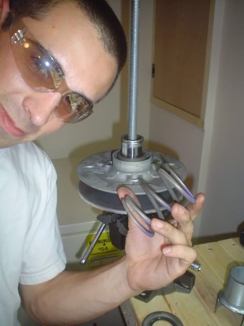

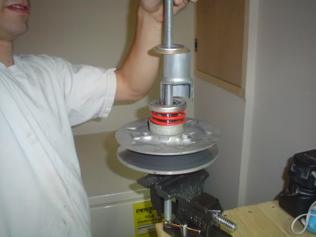

I'd also like to take a minute to show what I used as a modified spring compressor:
In Phreebsd's video on how to change a secondary found here I couldn't quite figure out what he was using at the top of his allthread to expose the snap ring. From what i can tell it's a pipe cap of about 2" in size, however I simply used an old muffler adapter of about 2 1/4" and grinded out a square section of the side. This is a lot easier since there's already a hole, which is handy if you don't have a drill press for that thick metal pipe cap. Total cost: about 14 bucks... (about 5 in my case since I already had a pipe fitting. Only difference, had to use a couple more washers. STILL about 70 bucks cheaper than the one you can order offline less shipping.
Please feel free to message me if you would like more pics of the project and how it came together for me. On a final note... I'm beginning to learn that SEARCHING FOR INFO FIRST and not being afraid to ASK QUESTIONS will greatly assist your first time experiences with your quad. Something that might turn out to only be a small problem may seem very daunting to someone who's just dished out 8 grand on a new machine but! Have faith in yourself: If you didn't think you could do the job yourself, you probably wouldn't have made it this far in, and finally... Be sure to thank those people that have assisted you with kudos and rep. :D

It was only about 24" but yes.... took a while longer than I anticipated. In the future I'm definitely shortening my allthread lol. What surprised me was the thin gauge metal on the adapter didn't seem to mind squashing down that tough spring. Was kinda worried about that especially since I cut a chunk out of it, hence the safety glasses. :22:
· Administrator
22,079 Posts
lol... yeah its a physics thing... anything cylindrical can take a lot more pressure verticle than you think. We learned all about it in school but, I Can't remember back that far! haha!
