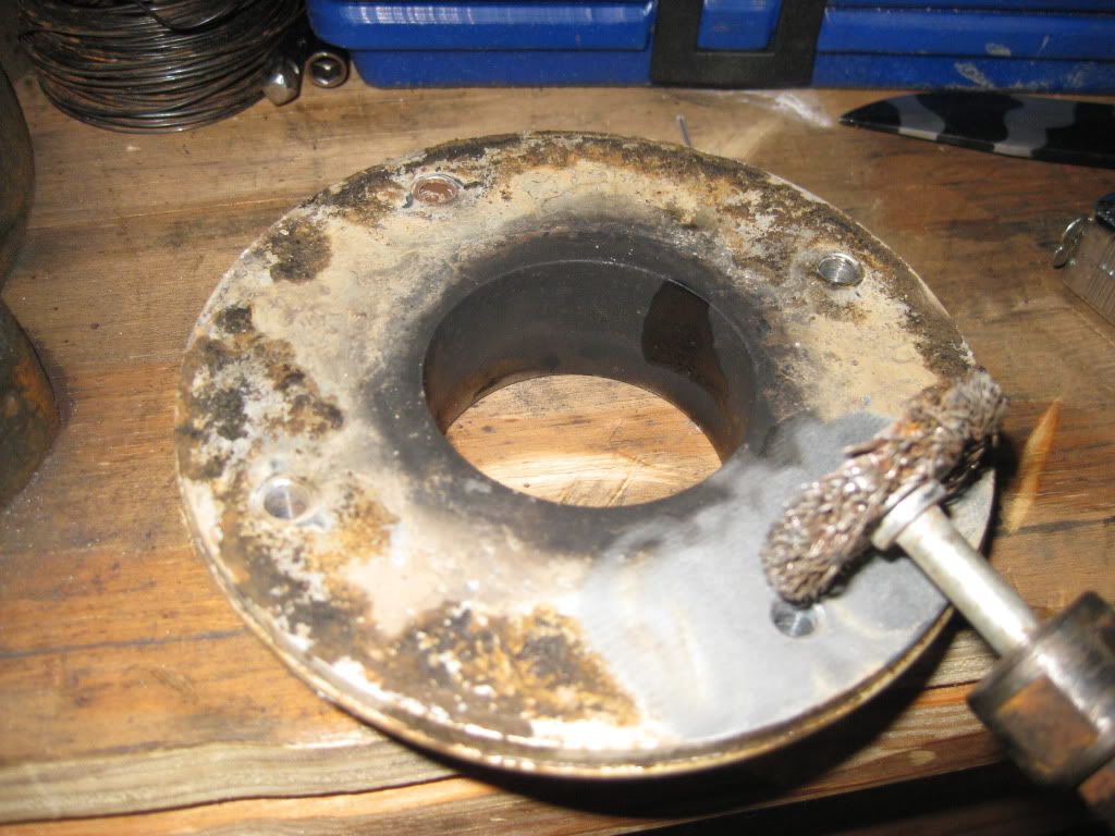

First thing to do is take off the end cap
Realized the sealing surfaces between the muffler and the end cap were quite dirty. i clean them up good
This is how the snork sits in the muffler opening and seals
here it is installed in the end cap
I added some RTV to seal it. These do have a leaking issue around the end cap. A single ring fixes that

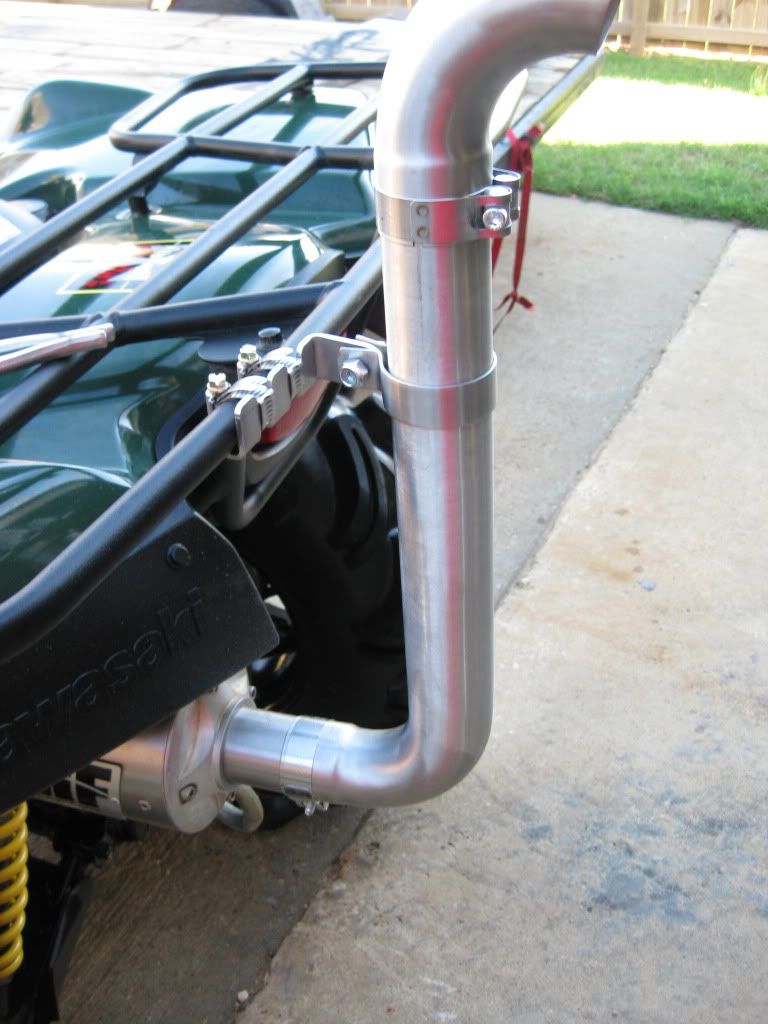

this is how the snorkel is secured to the rack. It seems very sturdy.

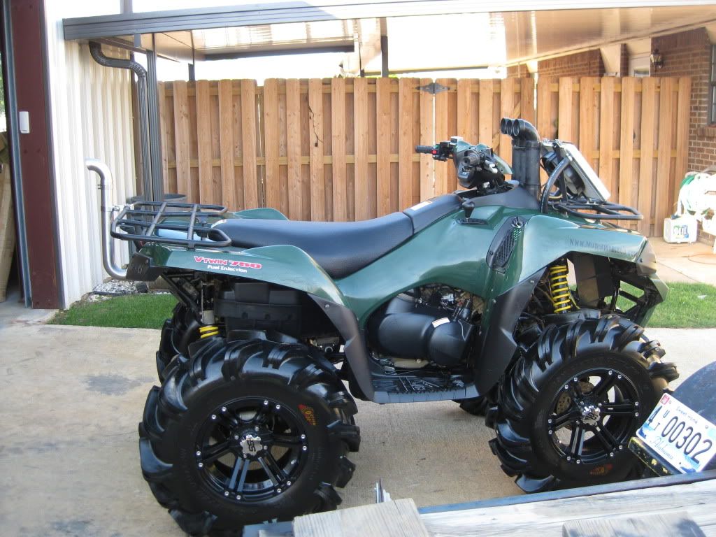

Finished
All done

1 foot extension added
