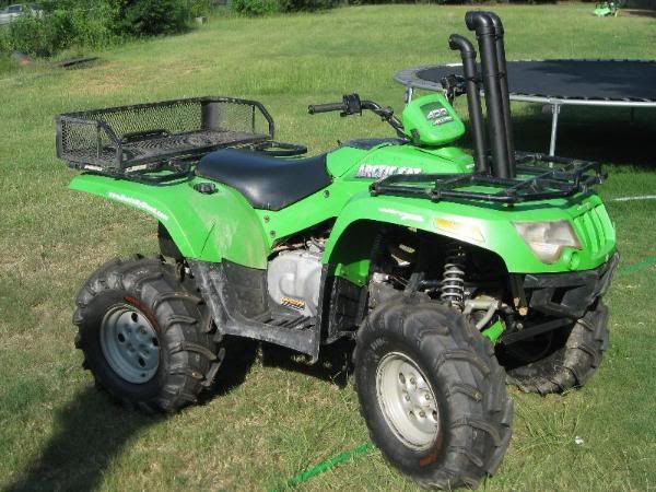

here's an write up I did a while back. I snorkeled my sister-in-law's bike.
And yes, she wanted the snorks that high.
if I can find the original doc I will just convert this to a post so you wont have to have adobe reader.

thats to much butchering up there for me to do it i would find a different way other then cutting my rack

haha yeah. i tried to tell her we can cut them down shorter...
she liked em like that.

Holy smokes that IS tall! :eek:
I'd never see over that, even though I'm standing when going through the good stuff.

you can do it without cutting the front rack. and if you want a cleaner look, you can use the rubber couplings right above the plastic. i found for cutting the holes cleaner you can take duct tape and put it on your plastic and trace the holes, then use a 2 1/2 or 2 1/4 inch hole saw.

the second pic looks like the snorkels are crooked but the rack wasn't
bolted down yet.

Where did you gey the flex pipe to run to the front?
Discussion Starter #18
all parts came from Lowe's
Resident Kitty Expert
791 Posts
you can do everything in hardline... it just takes a little plumbing skills.
14 Posts
I found 1 1/2" spa hose at home depot that will work, thanks.
