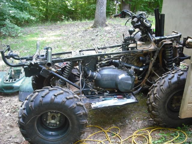

Im in the process of doing this as we speak, i will have some detailed pics of it and parts list.
14
Ok as promised here is mine i just did. I copied the best i could from the pictures above, and had to wing the rest of it. I took a little bit better detailed pics so yall can get an idea of how to do it and the parts you need.
And with the plastic back on and comepletely finished with new vent lines...
Feel free to ask any questions if you have any...
