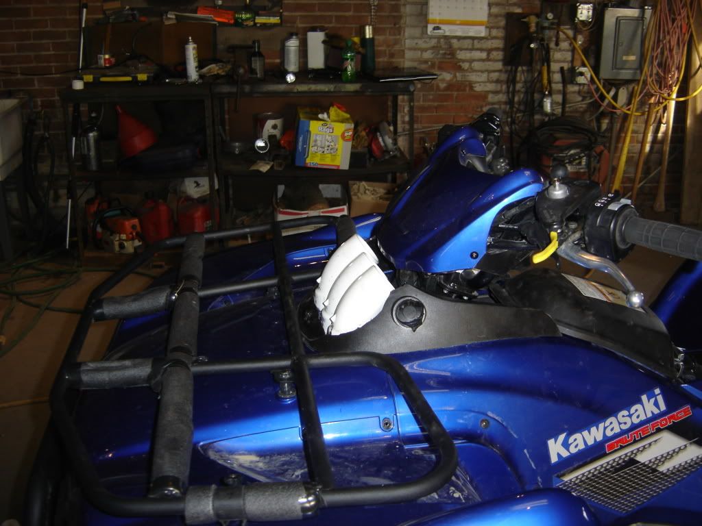

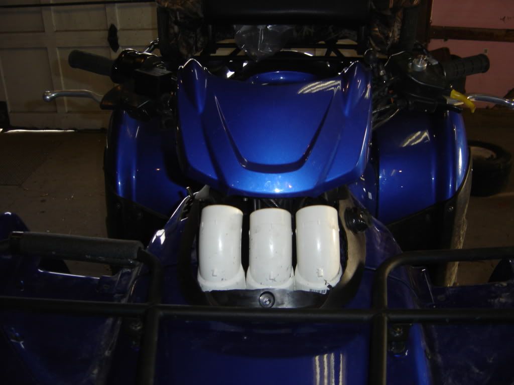

well iam almost done just have to paint the tops and really zip strap them down. i kinda hacked up the the front shroud so i ordered another one I dont think I will use my dremel on this one I could not cut a stright line to save my life. alot of guys r using under coating paint from auto zone right?

looks good! :rockn: yeah I used truck bed liner in an aresol(sp?) can... it works pretty good, just make sure you clean the plastic good, then let it dry over night after you spray them.

that's what i used aswell. you should paint your shroud with it too so the texture will match all the way across. i havent seen it done that way but i think it would look smooth! what's the rack padded for?

I know it's a personal preference but why did you make them so short? I've had times when my whole pod went underwater and would have drowned over those.

I really dont water ride I do alot of trail riding and just alittle mud but I heard all the stories about water in the motor. So just to be safe i snorked it.

looks good. i still would have made them go over the pod though, but its your snorkels

Well the bike is at HMF right now getting dyno tuned. I have to drive to Arkansas 2 night to pick up a boat from ranger then come back home and drive to hmf to pick up my bike. Then I have to put the axle in my old sportsman so i can sell it sunday so It might be till next week till i paint them.
Looks good man. You did good job.

I really like them low like that. I just like to ride water a lot so I would be nervous. I looks almost factory like that.

More pics please when it's done (and please continue to include the gf too :))!!
I like what you've done. I don't think I need the real high ones either (and don't underwater mud like these nuts ball on here :rockn:) and would like to see what yours looks like when it's done.

Trim your plastic with some black vacuum hose one you get finished. I'm ready to see it finished as well.

I looks great, like the short look. Shrouds are cheap if you dont like it, I butchered mine too the first time as well, so i got a new one.

well got my bike back from the dyno tune with the new snorks no more back firing. he said he changed the pilot jets and ajusted the screws. I only thing I dont like is when i hit the gas it has a hesitation to it. Is this cuz the snorks now do I have to put dual snorks on this thing to get rid of that. I tought if i keep them low and threw the bars it would not do this
So the hesitation is new behavior?

yea before u would hit the gas and the wheels would aim 4 the sky now u hit it and it takes a second or 2 to really pull hard
