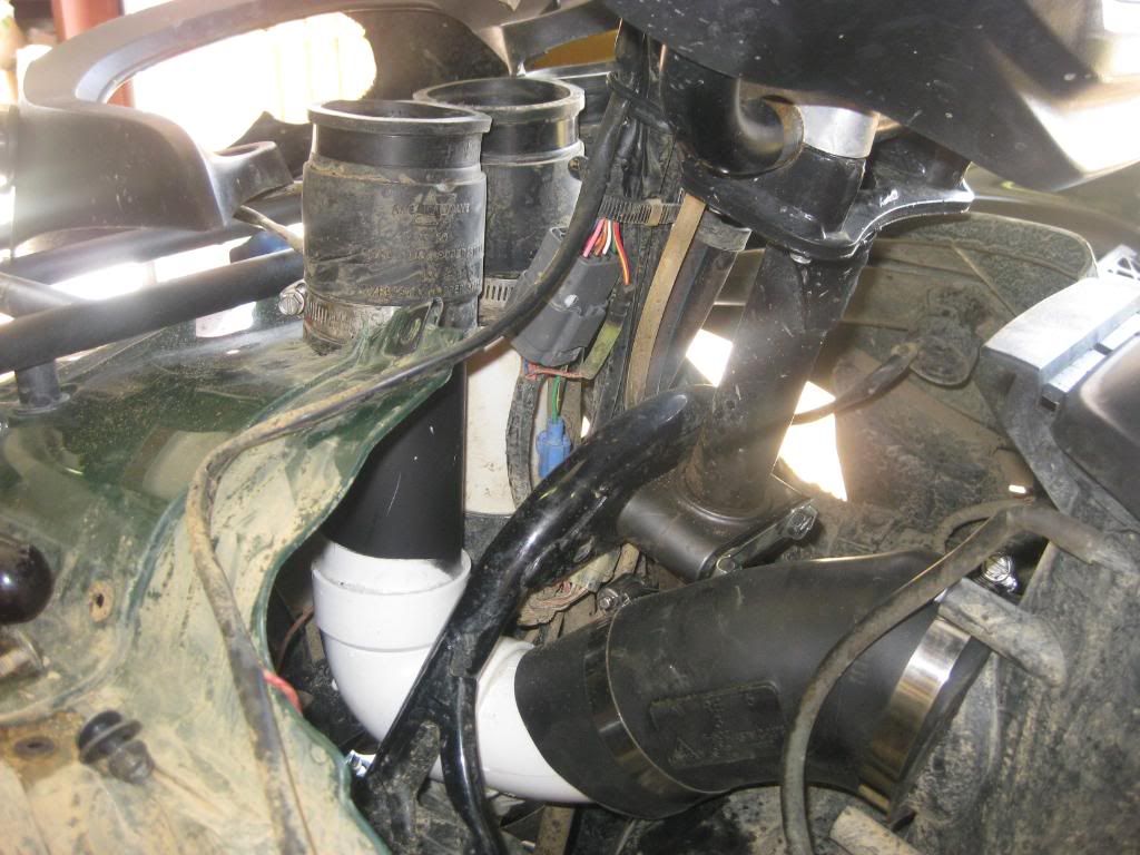

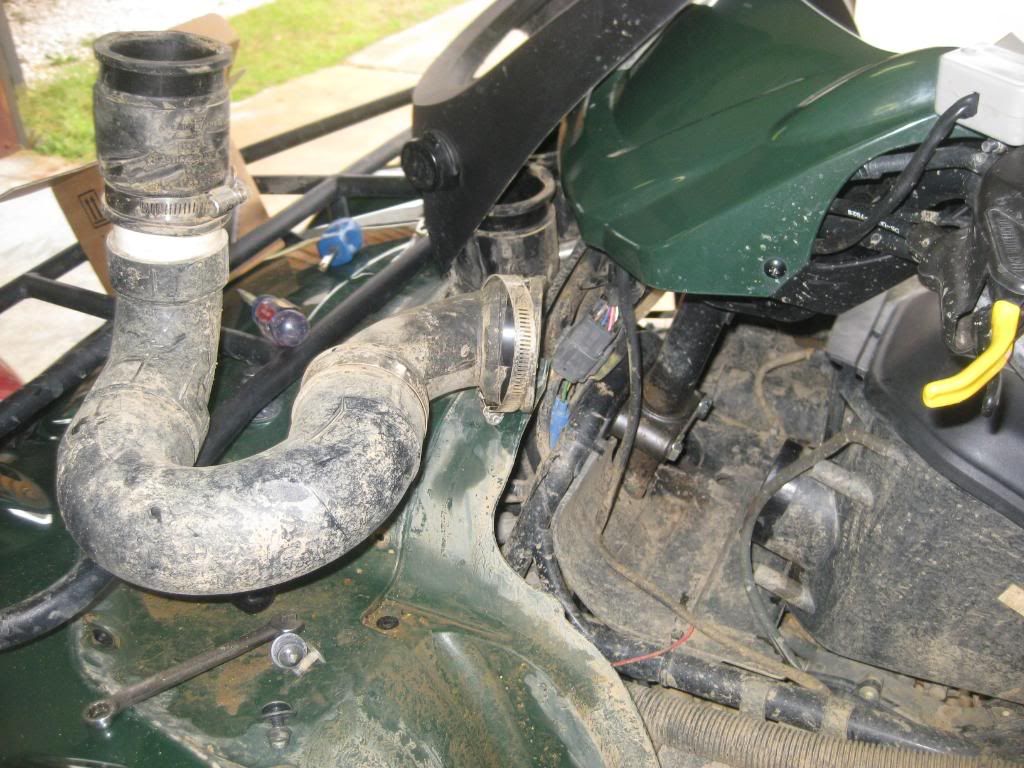

I changed from this

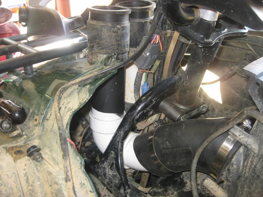

to this
Changing to this route lessens the bends teh air must take greatly. I used a 3" elbow and cut off the ends. Everything else is still 2" pipe.

He re routed the entire snorkel under the steering brace using the rubber 3" 90 instead of around it where he used a 2" 180* fitting(p-trap) It allows for more unrestricted airflow. All of the other fittings used in the project are 2". More info can be found here

Just use the 3" rubber 90 and other 2" fittings and route it under the steering brace as pictured and you will be good to go.

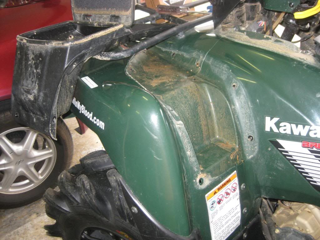

ok say if I did move my snorkes to the middle how do yall cut that center plastic to make it look so clean?
1,435 Posts
either
A) be real real careful and more crafty than me, or
B) Take a jigsaw and box knife to it like i did and settle for rough edges;)
a 2.5 or 2.75 or 3" hole saw would work too.
I cut my plastic with a drywall rotor but a dremal tool would work just as well. Take a scrap piece of 2" PVC and cut a 45 degree angel on one end.Hold the the PVC straight up and down so the 45 end will fit nice and flat against the plastic shroud. be sure you do the center one first that way you don't get them off center.Mark around the pipe with a marker and this will give you the shape of the holes you will cut. Once you have the holes cut use a razor knife to clean up the edges.
