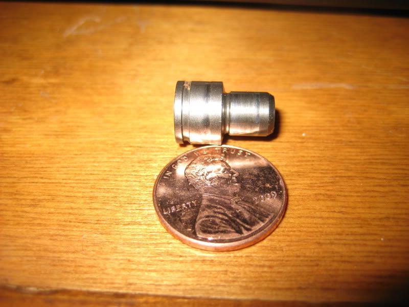

So I finished changing my clutch springs, putting on my 2" lift and putting on new tires. Took the bike out rode it around, everything is great, I was sweeping out the garage and among the clumps of dirt and bolts, I found this and I know it wasn't there before. It had fresh grease on it and I cleaned it off and don't recognize it. So, anybody know what this is?
Yes thats a pin goes inside your secondary clutch. Their are 4 of then that hold the two clutch sheaves together.
I would recommend putting that back in....LOL
This may help. Be sure you re grease it before you stick it back in.

Son of a B, I knew it was gonna be something like that. What is it gonna take to put it back in? I am pretty sure I didn't want to mess with those pins because I heard they were no fun to put back in.
Super easy to put back in. You can use a magnetic screw driver or just put a dab of grease on the tip of a flat tip screw driver. The grease will hold it in place long enough for you to reach inside the clutch and put the pin in place.
The pins just push back in place. Nothing to it......minus the having to take the clutch back apart.:aargh4:

So how could I get another one? Because I opened it up and saw that there are 2 missing now. I don't understand how they could have fallen out, I took the stock spring out and put the yellow one in without ever screwing with the internals.
they dont usually fall out. you have to rotate the sheaves into a position that they will come out. perhaps the factory left them out?
you can order them from the dealer or online but i think you will come out cheaper at the dealer. babbitts online likes to charge 14 minimum for shipping even if they are sending you a single feather.

MRcycles has them for 3.50 plus 9 bucks shipping. I just hope it comes in before next weekend.
