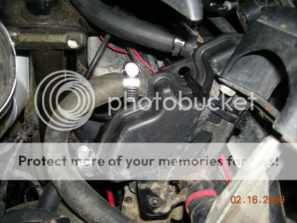

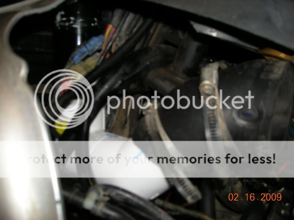

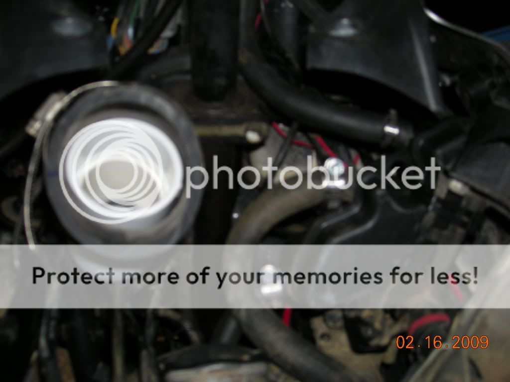

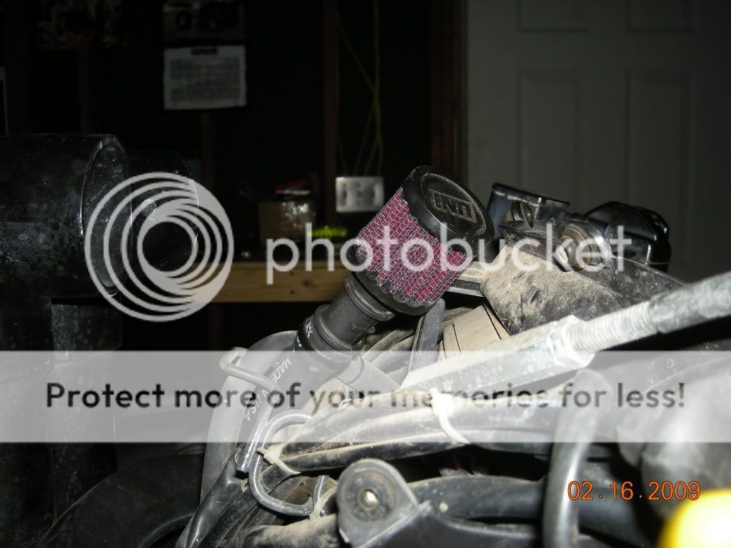

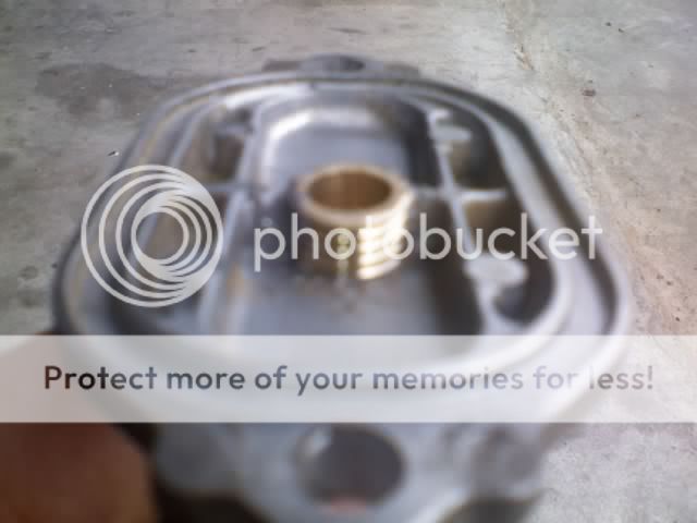

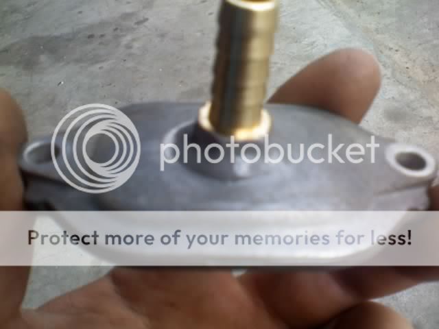

Heres the inspection plate with 3/8" barb fitting (1/4" pipe thread), I drilled a hole then tapped it, screwed the fitting in and put some J B weld on it just for safe measure

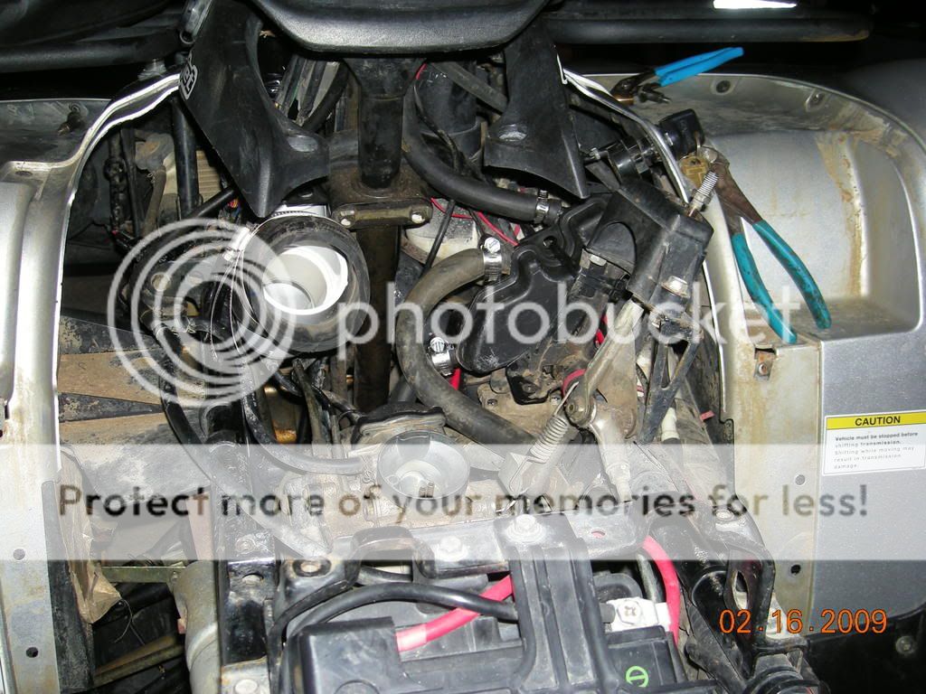

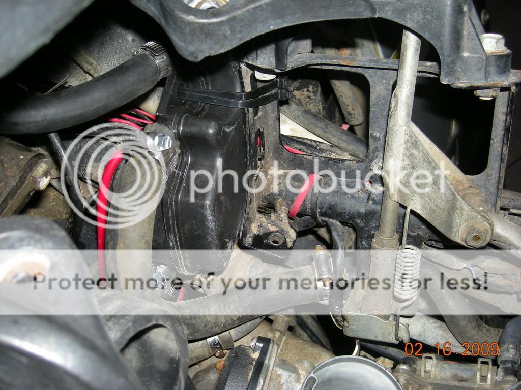

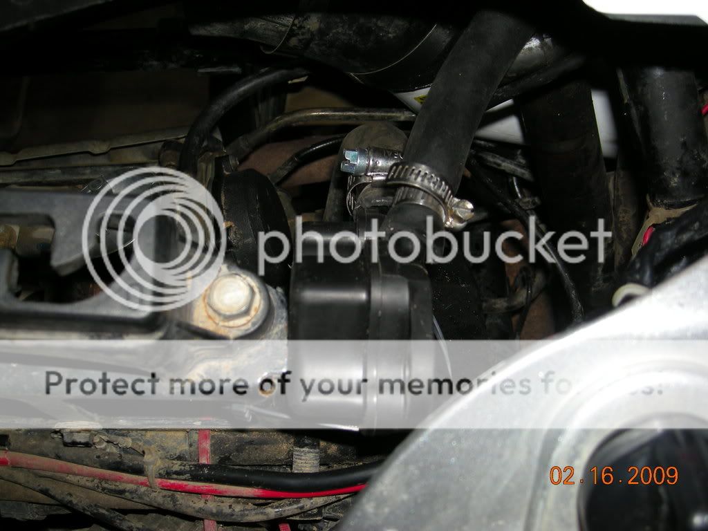

And several with it place and ready to go, installing it is pretty much self explanatory
I also redid the snorkel to go under the frame loop while I was at it and changed belt, put a pink primary in to give it a try
Now im back to getting the jetting right again!!!:rockn:

im guessin u went to the front cylinder? ill prolly be doin this mod pretty soon on mine.
63 Posts
I put mine on the front cylinder, works great. The only thing I did different was put the vent for the catch can back to the airbox. No more smoking on those long wheelies, even with the oil level at the H mark on the dipstick. ;) I think everyone should do this mod. Too many brutes having rod bearing problems. I would say its from oil starvation, from running oil level to low.
where'd you get that cool little filter?
Nice job, btw. :)

It is to the front cylinder, also
I got that little UNI filter from denniskirk.com, ordered a few things from them and saw that and got it too, ive had it since i moved the crank case vent to the pod
It took me awhile to find a good area to put the catch can. That was the best spot I could find and works great there, so far!
And as far as jetting with the snorkel goes its running lean on the bottom end about 1/8 to 1/4 throttle, got to figure that out but wide open seems to be fine, ill have to do some plug checks to be sure, just havent had a chance to really mess with but i might be going riding this weekend, well Saturday, so I need to get on it!!!

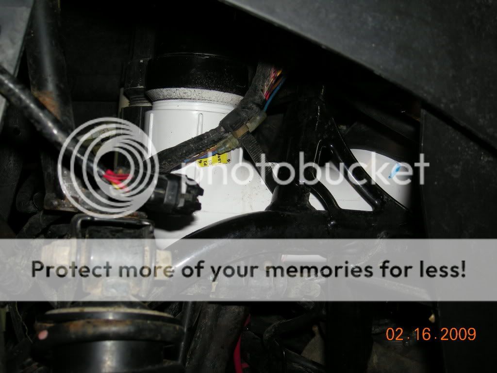

here's another mounting location
780 Posts
That's not a BF. Is it? The t-stat and rad are not in the same place.

I was thinking the same thing, hard to tell what it is by that picture but i know its no brute, maybe a Prairie, V-Force
it's no brute. :(
i think there's room to place it here
I found this pic of the catch-can all by itself. For people wondering just what it looks like (i know there are pics above)
